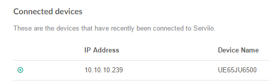

Issue: Serviio stopped working after upgrading from Windows Server 2012 R2 to Windows Server 2016 -- Console shows TV is connected, however TV does not see Serviio anymore (no source icon on TV).

The following URLs are accessbile from network devices and TV:
https://10.10.10.237:23524/mediabrowser/
https://10.10.10.237:23523/console/
TCP ports 23423 and 23424 are open on the server.
TELNET to the server ports 23423 and 23424 is okay using network devices.
UDP port 1900 is open on server.
PsPing to the server port UDP 1900 is okay.
