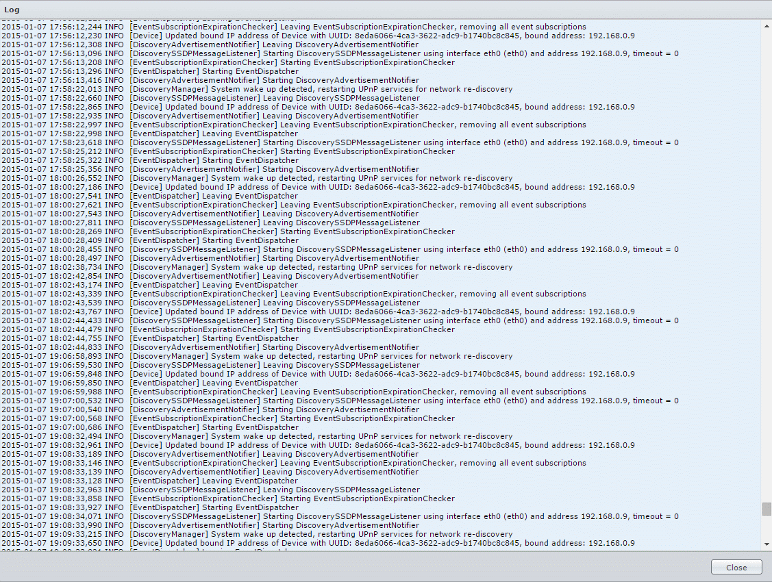

Hi Guys, I have the same problems with my Samsung TV which randomly gets disconnected from Serviio while watching a movie. Sometimes I it happens once per 3 movies, sometimes 3 times during one movie and never in the same moment. I attached a log file with hope that someone will spot something interesting in here as today I started to watch movie after 18:00 I think and by 19:10 I got disconnected twice and after the second one I could not play it back so I watched this from memory stick.
Samsung 46C750
Synology: DS112j
Firmware: 4.3-3827
Serviio: 1.4.1.2-0026
Router: Sky (Model SR101)
Please help
Tom
log Serviio.gif (232.81 KiB) Viewed 21212 times
