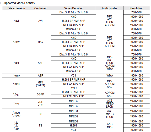

I have been reading trough tons for treads, but with no luck, why I hope somebody can help me further here.
My TV is a Samsung LE46B650 television.
I'm using the Samsung B Series profile, and as far as I can see it should be fully capable of transcoding DTS?
Skærmbillede 2014-08-07 kl. 20.14.09.png (87.34 KiB) Viewed 5296 times
I'm trying to play a MKV video, but do only get picture - no Audio
Further I'm unable to jumb forward in the video.
Attached the also the MKVinfo and my log file.

Is there any way I can determine weather the audio is transcoded and streamed from Serviio, or about my issue is related to the TV
Hope somebody can help me with getting audio :o)

Try downgrading ffmpeg to the one contained in the 1.0.1 or 1.1 Serviio release
See this thread: viewtopic.php?f=10&t=9652
- let's know how this work out for you
/Nanoflower
Post Thu Aug 14, 2014 4:01 pm
Re: Missing audio on Samsung B series
DTS is not supported by the B series. Thus the Samsung B profile transcodes it to AC3. make sure you have this profile selected and transcoding on.
